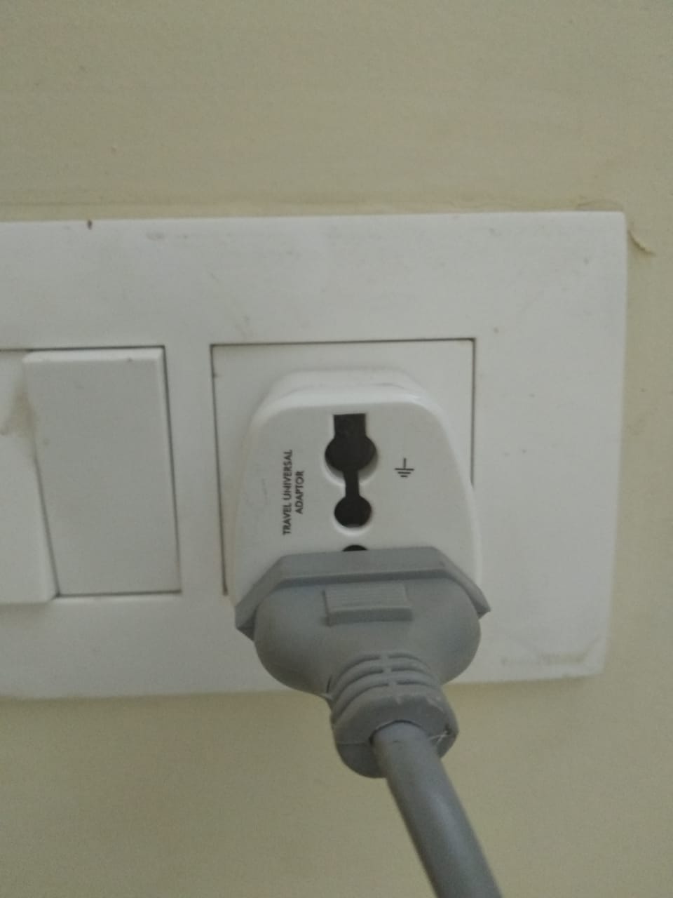

I am using portable charger to charge the vehicle as I could not get the permission from the apartment to install the charging pod. But for some reason it is not charging from that adapter also.
From 1st floor I am using an extension cord to my parking slot. Adapter light turns green when the switch is on but when connected to the vehicle it turns red.
I have tried the same adapter in the Ather public charging point as suggested by them, it works perfectly. Also it works on some of the sockets in the common area of the apartment.
When I reach out to the Ather support they suggested to get an inspection on the flat for the same. But when I did he says everything is fine. Due to this I am unable to use the vehicle as my primary vehicle for the daily commute.

Hi, Issue is with your ground connection. Do you know what is the voltage between Neutral and Earth points? When this voltage is high then the portable charger LED will glow red.
Oh I see. But my assumption was if the ground connection is not proper it should be the same case across all the sockets in the apartment. But the one in the common area worked fine for me.

Your extension chord also must be 3 pin. Either a direct one or one with a spike buster. That’s probably where the grounding is going wrong.

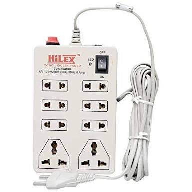

Hay, @abhishek.balaji2 thank you so much. The problem was with the extension cord itself. Got one of these below ( which has fuse ) and now it’s charging without any issue. images%20(1)
This is a 2pin without the earth pole. It should ideally not work :smile:
As @abhishek.balaji2 suggested I have used 3 pin adapter with the extension cord. But even with this 3 pin adapter I had tried yesterday and failed to charge. But I didn’t know it’s mandatory though. Good leaning :wink:
The extension cord has only two pins so it won’t work. Get a extension cord with 3 pin plug and try.
